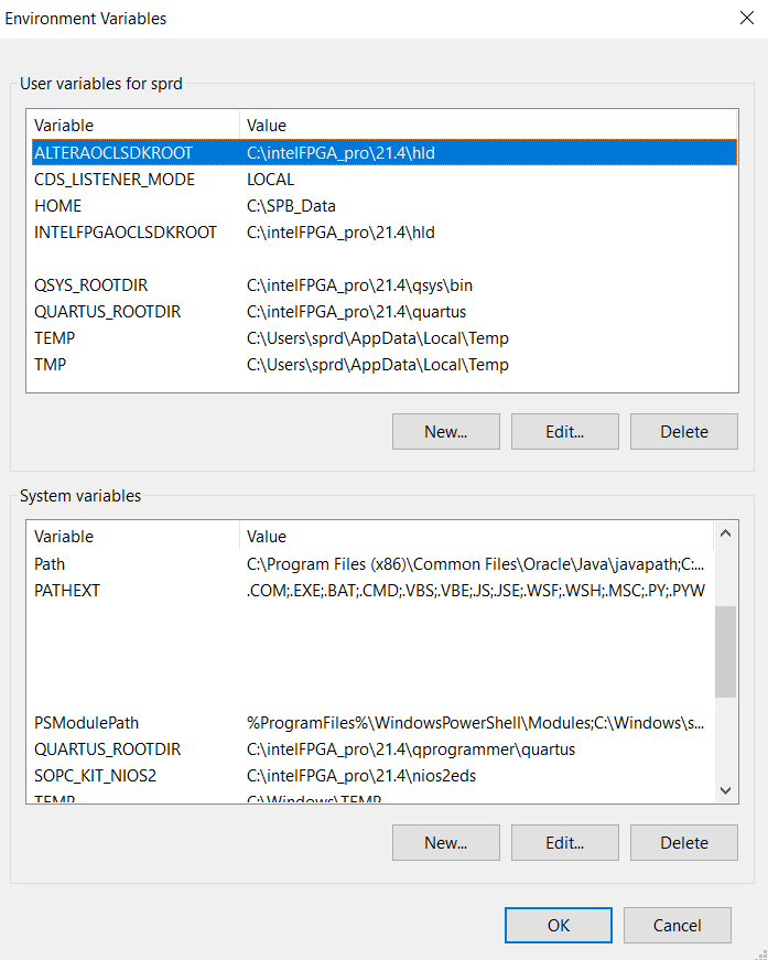

As mentioned, how are your Quartus-related environmental variables set up? You went back to an older version of Quartus where System Console lived in an sopc-builder directory instead of syscon, so your paths may be messed up.

Hi @sstrell ,
see attached Quartus environment variables.
From your post it seems the issue is the order of installation: 21.4 > 17.1 , which could mean that it could get fixed by re-downloading a later version (21.4, 22.4), and installing it?
