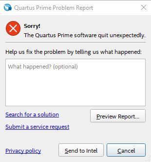

Quartus quit unexpectedly
When I tried to compile my code, I got this error, anybody can help me? thank you very much!
Problem Details
Error:
*** Fatal Error: Access Violation at 00007FF96AEB4786
Module: quartus_syn.exe
