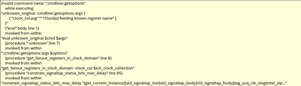

Quartus Prime pro 25.1.0 Build 129. Power Analysis failed due to 332000
Greeting,
I add signaltap into my design and build the image. It failed at "power analysis" step with error:
which I think relate to signaltap. I add signaltap using GUI which I am not in control of SDC.

    Can you provide me the design.qar file and also the steps to duplicate the error?

    Do you have Quartus 24.3 installed to help test this? It looks like the issue only occurs in version 25.1.

    I tried it with Quartus 24.3 and it is ok. seem like only newer version (25.1) is having issue.
