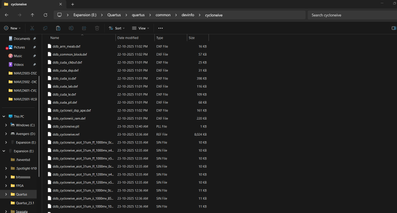

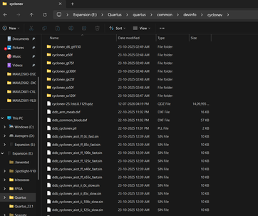

I did try that as well its still the same. I tried the same for the 25.1 version and i downloaded it but i am unable to get any devices. I am able to see only Cyclone V boards and nothing else. I also tried installing the devices separately. But in the device installer it said that those devices are already installed. I checked the device files and i seem to be missing some files. I will share the screenshot of those. I would appreciate any help.
The first one is the Cyclone V and the second one is Cyclone IV E. Can anyone please help me.
