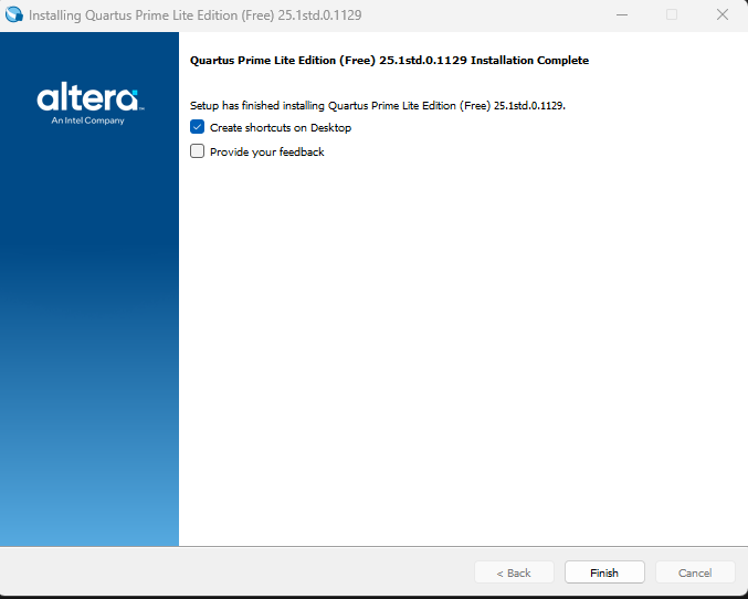

Hello to the community.
I had some problems while installing Quartus Prime. Though in the end I finally succeeded, maybe someone will point out what I've done wrong.
Here are the steps:
  1. I started installation by executing the setup.bat command file.
  2. Left the configuration all default as well as the installation directory.
  3. The software successfully unpacked the files and started installing the help component.
  4. After a while it reported that it was done by the "Installation Completed" message and full progress bar.
  5. I waited for a while and then forced this window to close. It displayed some error message and quit.
  6. No further progress was observed after some time, so I killed that process too.
After that I played a little with installation directories, turning on and off the antivirus, but nothing helped. In the end I came up with the following solution:
  1. Again, execute the setup.bat.
  2. Disable help installation.
  3. Wait until come other component reports it's done and do not responding.
  4. Kill that process and see some error window.
  5. Wait until installation is done.
  6. Install the help.
I'm attaching a few screenshots depicting this behavior for the Ashling RiscFree component below.
Though in the end I did obtain the software, it is still quite annoying and time-consuming. Maybe there is some tweak to make it smooth?
I'm using Windows 10 version 10.0.19045.6466.
Thanks in advance.

    From your description, it looks like you are installing Quartus Prime using the .tar installation method (setup.bat).
    To better understand the behavior you’re seeing, could you please share:
    -Your system RAM size
    -Available disk space
    -Approximately how long you wait when the installer shows “Not Responding” before manually terminating it?
    Your installation flow is correct: run setup.bat, select the components to install, and allow the process to continue until the installation finishes. Upon successful completion, a GUI window should appear asking whether you would like to create a desktop shortcut.
    In your case, however, the installation becomes unresponsive and appears to hang.
    I have tested this on my side and was able to install the Ashling RiscFree software successfully.
    In some cases, the .tar-based installer can take a longer time to unpack and complete, depending on system performance and storage speed. Even when the UI appears unresponsive, background installation processes may still be running.
    In general, I would recommend using the Quartus installer instead. This installer allows you to select only the components you need and auto install.
    Important: Please note that there is a known SSL certificate issue affecting the installer. You will need to follow the steps in the KDB article below if you encounter download or installation failures:
    https://community.altera.com/kb/knowledge-base/test-download-failed-with-certificate-error-ssl-certificate-problem-unable-to-ge/351512
    Below are standard troubleshooting steps I usually suggest, which may help identify or resolve the issue:
    1. Before you download and install the software, please check that your machine system met the minimum Hardware and Software Requirements. Ensure that your Operating System is supported. 
    Altera Documentation and Resources Center
    FPGA Operating System (OS) Support
    2. Check that the disk space is sufficient for the installation of the Altera FPGA software.
    3. If you are running antivirus software, try to temporarily disable the antivirus software during the Quartus Prime software download and installation process.
    4. Install the software with Administrator privileges.
    5. If installing via .tar, please re‑download the installation package and verify that it is not corrupted (for example, by checking checksums).
    From past experience, copying the .tar file to or from a network drive may corrupt the archive:
    https://community.altera.com/discussions/quartus-prime/quartus-prime-pro-20-1-install-hangs/275314
    6. Try to download and auto install using the new Quartus installer.
    7. Check your OS history update, e.g. to check if the issue happen after some specific Window update.
    Richard Tan
