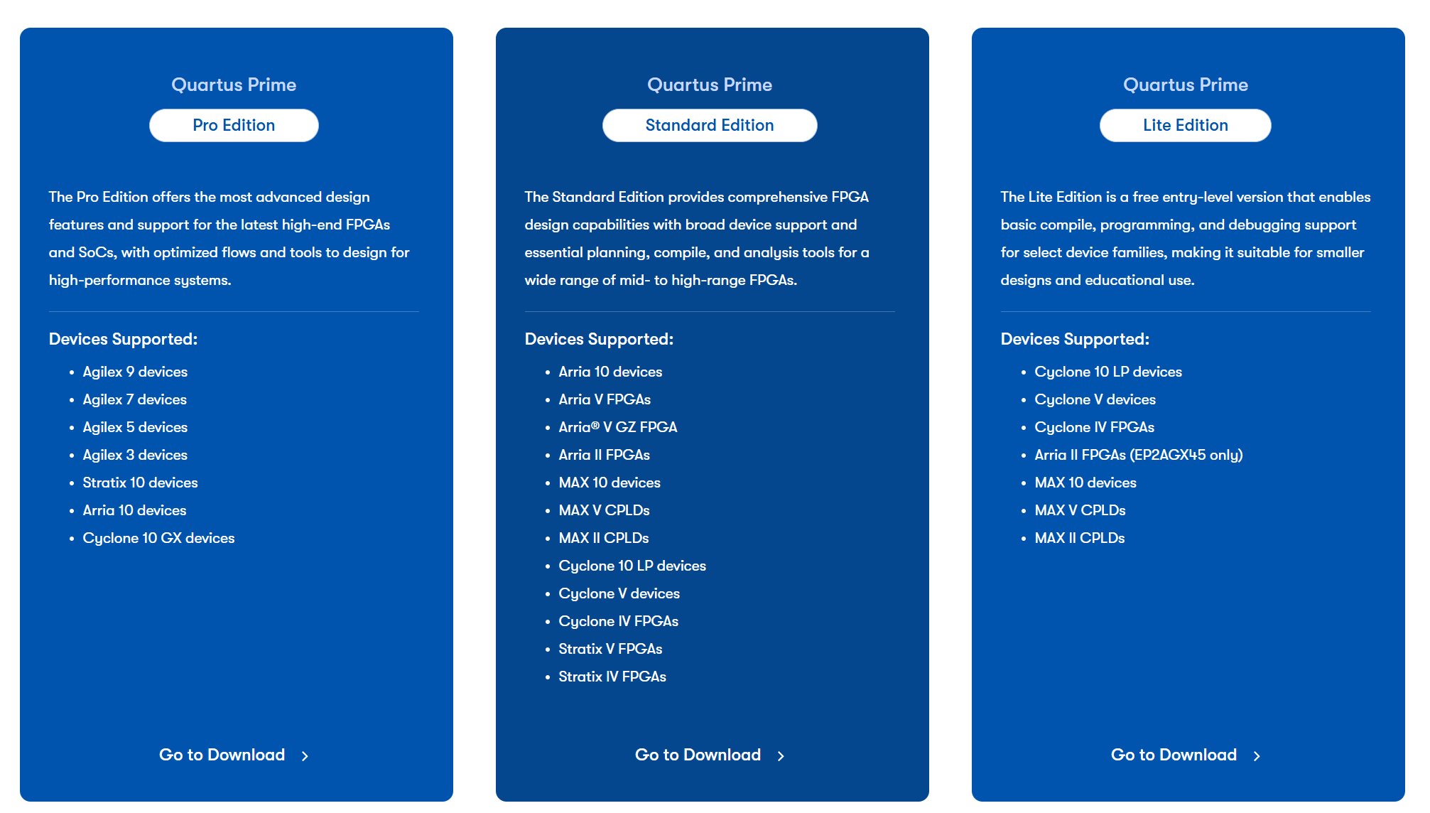

Trying to work through configuring our MAX 10 device for encryption. Best I can tell so far I need a license to unlock this feature? I tried navigating through the Altera Self Servicing License Center and was unable to find anything. Can you please inform how I can obtain a license?
  • Farabi_Altera's avatar
    Farabi_Altera
    You need to puchase Quartus Prime Standard Edition license to enable the MAX10 design security feature. Quartus Lite free edition will not have this feature.
    regards,
    Farabi
    • Puzzle's avatar
      Puzzle
      Ok, can you point me to where in the documentation it is described that paid software, such as Quartus Prime, is required in order to utilize security features? I am usually looking for this kind of stuff when selecting chips and I am surprised to hear about this.
    • Puzzle's avatar
      Puzzle
      There is a similar post from years ago discussing the use of Quartus Lite and encryption with Max 10 devices where the Altera rep who responded pointed to a license to unlock this feature. I had chased this down last week and was unable to find any such option in the self-service licensing center. Not very keen on the pay-to-play model here if something has changed and I really do need to upgrade to the paid version of Quartus to unlock a feature present on the silicon we're paying for.
