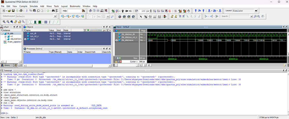

    I have no issue running nativelink simulation flow using Quartus 24.1std and Questa Intel FPGA edition.
    Could you try to upgrade the tool and see if the issue still occur?

    Any update on this?
    Do you able to resolve the issue using the Questa Intel FPGA Edition?
