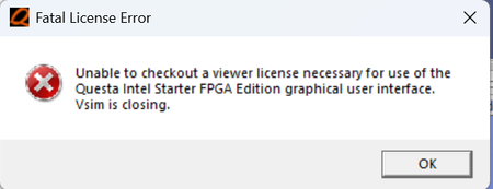

Quartus GUI License Error
- 10 months ago
Could you check whether the NIC ID associated with the license file is correct? Also, can you confirm if this is a Fixed type license?
5.5.1. Identifying Host's NIC ID
Richard Tan
I’d appreciate it if you could confirm whether the issue is now resolved?
I still get the same message. I am using the 24.1 lite edition, so my path needs to link to LM_LICENSE_FILE, I think? Are there are other suggestions?
- sstrell10 months ago
Did you try SALT_LICENSE_FILE as suggested?
- ShengN_altera10 months ago
Try re-generate the questa license and make sure nic id is correct. Also try with SALT_LICENSE_SERVER environment variable (fixed license). If still cannot, use float license and set up license server using daemon. Related KDB link https://www.intel.com/content/www/us/en/support/programmable/articles/000099465.html
