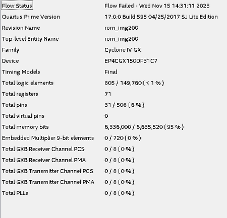

Quartus Error: Can't place all RAM cells in design - Seeking Help

M9Ks only has these configurations
1 bit x 8K addresses
2 x 4k
4 x 2k
8 or 9 x 1k
16 or 18 x 512
32 or 36 x 256
Make sure M9Ks are being used efficiently. Any bits or memory space that cannot be mapped will then be wasted.
For ROM-1 PORT, try to adjust the Set the maximum block depth check this manual link https://faculty-web.msoe.edu/johnsontimoj/EE3921/files3921/ug_ram_rom.pdf (page 13). Probably can help to reduce some of the M9Ks usage. The resource usage box can be checked at the bottom left corner of ROM-1 PORT GUI. The RAM Summary located in Fitter -> Resource Section.
Btw, the DE2-150 design example only consumes 2,664,296 / 6,635,520 ( 40 % ) memory bits and 351 M9Ks.
