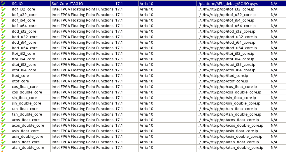

      I opened the project with Quartus, and all IPs seem fine.
