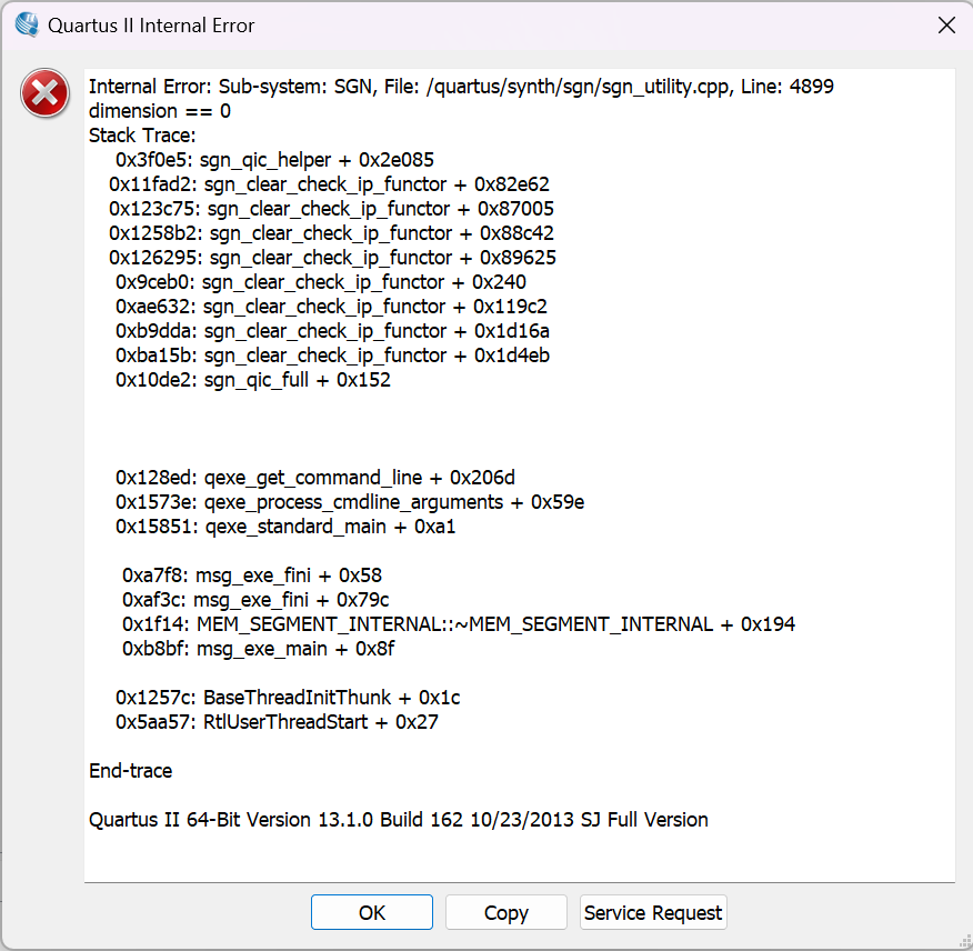

When we were using quartus for the synthesis process, we encountered a problem that caused the program to crash abnormally. Our 'rtl.v' file, which is set to be the top file of the quartus project, experienced an interruption in the synthesis process, which eventually caused quartus to crash. In order to facilitate the recurrence of the problem, we have attached the project where the crash occurred to the submission, in the hope that this will help you locate and resolve the issue.

  • Engineering found that the root cause of the error is that Quartus standard incorrectly processes the escaped names of the type
    reg [7:0] \cfblk203_reg[0] ;
    This is in the file Subsystem_yosys.v
    I see that the file is generated bythe yosys tool. yosys may have an option to generate the names differently.
    For example, if we change the name to
    reg [7:0] clkbuf203_reg_0;
    This will be handled properly by Quartus standard.
