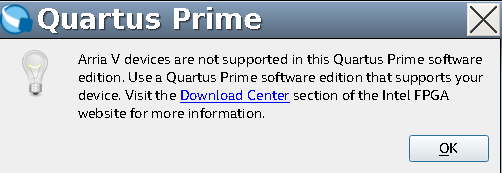

I have created a 90-day evaluation for Quartus Prime Pro 26.1. I could not get it to build, does it not seem to support the following FPGAs, is this expected?
- Agilex 5 Engineering samples A5EC065BB32AE4S
- Arria V Production version

Arria V is not supported in Pro. You have to use Standard:
https://www.altera.com/products/development-tools/quartus/compare

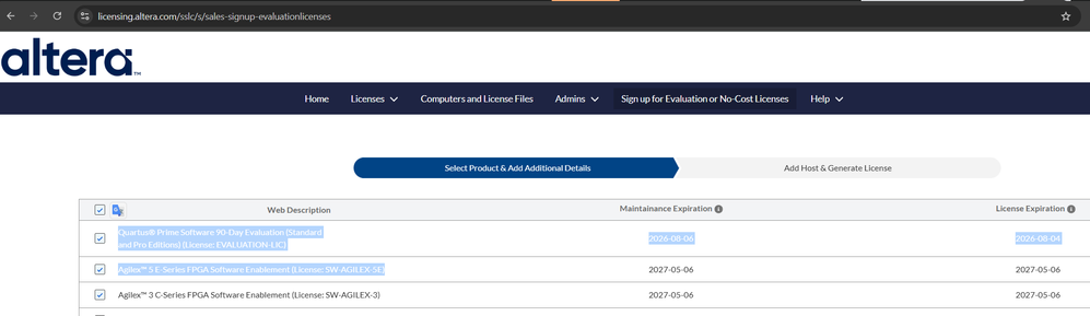

Not sure about the Agilex 5 issue. How do you have your environment variable set up for the license?
- ShengN_altera
May I know you use float license? If yes, could you use newer daemon?
Does fixed license got problem as well?
- covfefe
I have both Quartus installed.
I am using 21.1 standard for Arria V. These are fixed licenses, not floating- ShengN_altera
Agilex 5 needs another license. Have you use both Quartus prime and Agilex 5 two evaluation licenses?
