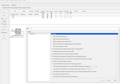

I would compare programmer options of both Quartus installations. Under circumstances it is necessary to disable the on-chip configuration controller during programming.
Which is the involved device, is it MAX10?- Bop2 years ago
Hi, thanks I'll test that.
Yes, it's about 10M02SCE144.
Regards, Patrick
- Bop2 years ago
Hi Aiman,
Quartus 18.0 and Quartus 23.1 have the same settings.
The "Enable real-chip configuration controller" was allready disabled.
Do you have further suggestions?
