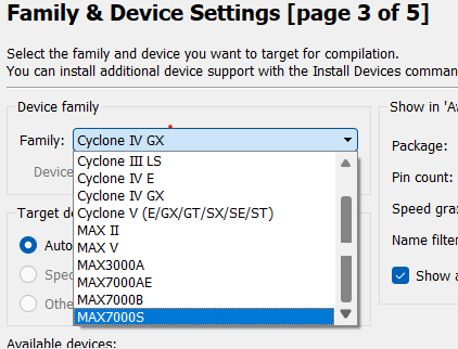

When I was about to give up, i decided to reinstall everything from scratch and install again, this time around using the .iso files and that seem to do the trick!Here are the steps i followed (just in case someone might find this helpfull) which include part of the suggestions made by Richard.
1. Uninstall everything, making sure there is no residue file in the installation directory.
2. Restarted my computer
3. Downloaded Quartus .iso file, verified Checksum was ok and install it using administrator privileges.
4. Downloaded Quartus devices1 .iso file, verified Checksum was ok and install it using administrator privileges.
Note. I used the DeviceInstall.exe from the Quartus devices1 .iso.
5. Checked by creating new project with wizard and scrolling down on the familiy tab
All in all, thank you for your quick reply and troubleshooting steps!Hopefully, this thread will be helpful to someone else in the future.
