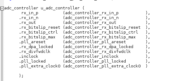

I receive the following error in compilation :
Error(16812): Verilog HDL error at safety_top_level.sv(178): port connections cannot be mixed ordered and named. Or there might be a trailing comma in named port connection.
what can be wrong here ?
Thx
Kikoss
  • You don't say which line is line 178, but you're missing a dot in front of rx_in_p.
