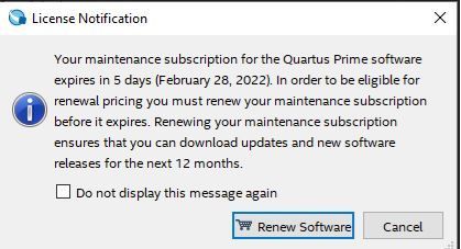

We've gotten our renewal license and I've downloaded the the file to apply on FlexLM. I've made sure to apply the necessary parameters on the license file. When our users launch the Quartus software they get a licensing notification pop up:
Please assist. Our users need to do compilations

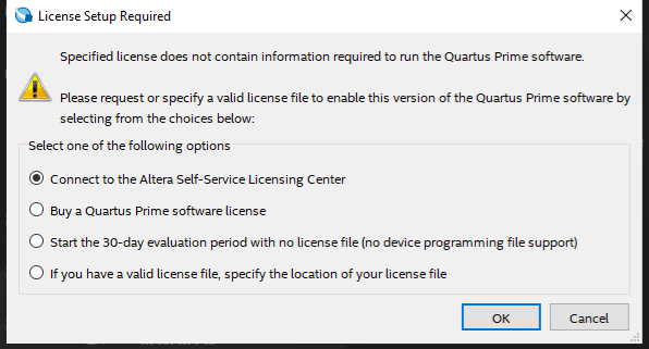

      Hi I just tried that and the users are getting the following notification:
      Our users need to use the software. How am I able to escalate this with support?
      Please let me know
