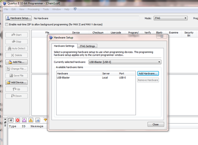

    Hmmm. Same software for me (QuartusII 13.0sp1 Programmer) and with a USB Blaster plugged in and driver installed, works fine.
    I suspect you don't have a USB driver (correctly) installed for your USB Blaster.
    My screen shot:

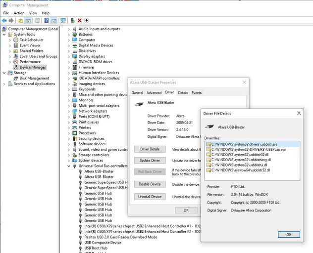

    And if I go into my Windows10 Settings / Computer Management / Device Manager, I see the Altera USB device and the installed drivers:
    • Niko3's avatar
      Niko3
      One of the two .sys files in your configuration is different from mine. I have edevmon.sys instead of USBPcap.sys and
      the provider is ESET instead of FTDI ltd.
      I will look for FTDI drivers.
      Thank you.
