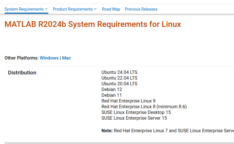

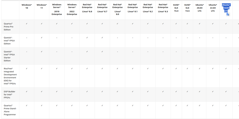

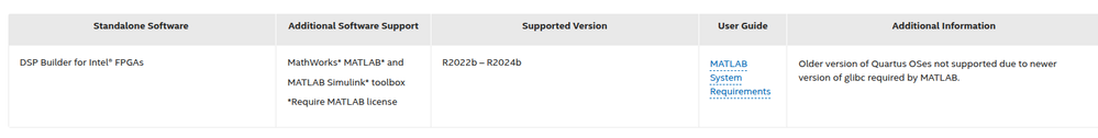

I have meet a wierd situation in Ubuntu. I installed Quartus prime pro v24.1 in Ubuntu 24. I can compile the design from DSP builder(R2024b). I think I checked intel websites regarding compatibility. I followed them and download and installed accordingly. However, I can't create/update diagram from Quartus Prime Pro 24.1. The options are unclickable.
