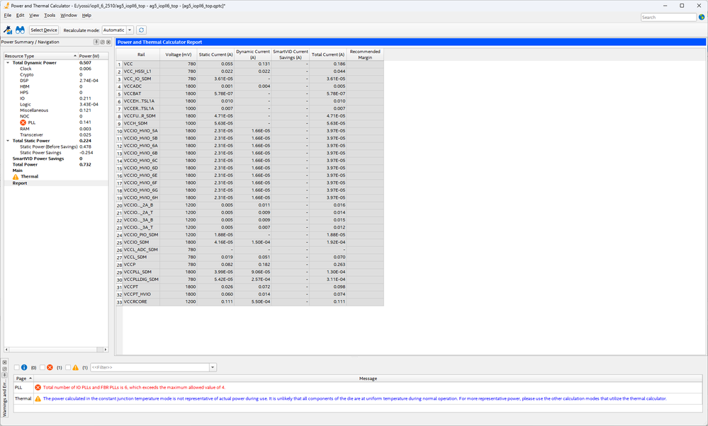

The attached .qar file is that you can see my concern.
If you have further more need, please let me know.
MAC_Yossi
Hello Aquid
When I checked with version 25.3, the error disappeared as shown attached.
From this, can I ignore the error displayed in PTC of version 25.1 and use it?

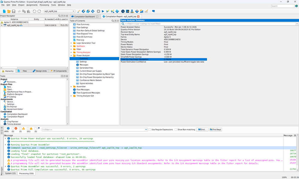

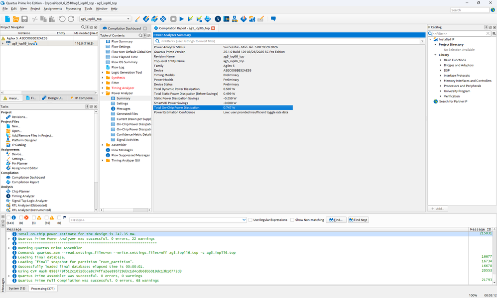

v25.1) Compilation Report > Power Analyzer > Summary
Total On-chip Power Dissipation = 0.747 W
v25.3) Compilation Report > Power Analyzer > Summary
Total On-chip Power Dissipation = 0.749 W

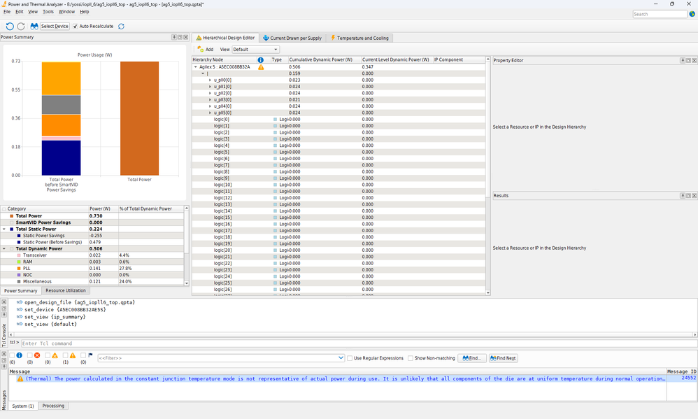

Also on PTC, there is little bit different power between both version as shown below. The setting is default.
PLL IP was updated when changing from v25.1 to v25.3.
v25.1) Total Power = 0.732
v25.3) Total Power = 0.730
