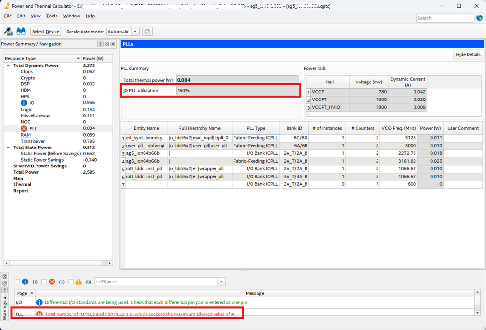

PLL number of Power and Thermal Calculator
How is the number of PLL of PTC tool displayed?
There is an error, but since it is compiled and power consumption is calculated, can I assume that there is no problem?
Please see the attached for details.
<Question_details.xlsx>

    Thank you for reaching out to use. Allow me to further support you on this issue.
    Thank you for providing details questions and I understood your concern. May I know if you willing to share the .qar file for this project to me through private chat? I would like to reproduce the error on my side.
    It seems safe to say that this is okay since the design can be compiled and power calculated successfully, but I also need to have some verification from my side to see if the error is consistent in latest version.

        Hello Aquid
        When I checked with version 25.3, the error disappeared as shown attached.
        From this, can I ignore the error displayed in PTC of version 25.1 and use it?
        At this moment, it is necessary to develop with v25.1 to match the version of IP made by 3rd Party.
