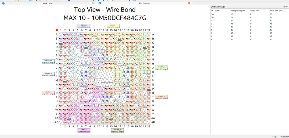

I accidentally deleted the all pins block on the pin assignment. I have tried to go to the all pins under tools and it is checked off like it is on the page but I can't see it. Does anyone have any advice?

    I am guessing you are saying that you accidentally closed the All Pins list in the Pin Planner and you can't get it back.
    It gets displayed from the View menu, not Tools.
    Perhaps you've dragged the edge of the All Pins list too far to the side of the main Pin Planner window. Or you've turned on the Auto Hide option (the little thumb tack icon) in which case you have to click "All Pins" to bring it back.
    Maybe a better description of the issue would help.

      Thank you for the reply. Sorry, I'm not very familiar with this program yet I am currently taking a class that uses it. When I go to the view menu the All pins has a check mark. and when I press the little thumb tack icon my messages comes up but not the all pins.
  • In the screenshot you have provided, I feel like the Pin Planner Window is attached to the Quartus Window.
    Could you "Detach Window" back to its own "Pin Planner" window so it is more convenient to look into.
    Which thumb tack icon you have clicked? I assume it is the All Pins' thumb tack, then it is minimize at the edge of the window. You might need to look around.
    See if you might happen to detach the All Pins from the Pin Planner. Then it might not in the Pin Planner GUI. It probably flying around somewhere. Close and reopen the Pin Planner GUI window might helps to resurface the window.
