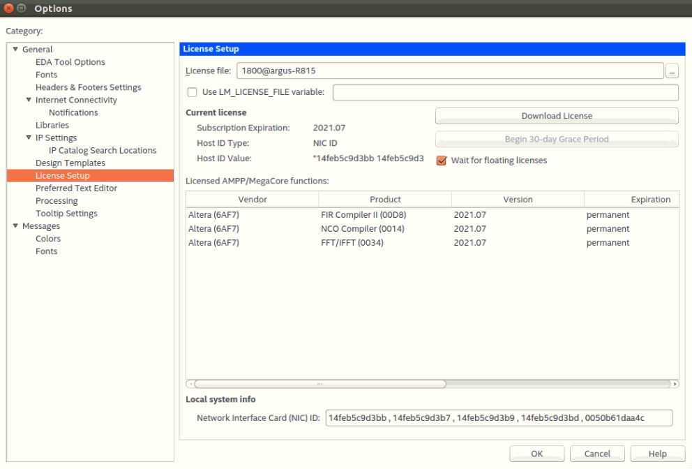

this is how my license setup looks like:

Hi ,
Looks like your license file does not include the partial reconfiguration feature.
Please let us know whether you are intending to use the partial reconfiguration feature if not please see the link below for a related thread to a similar issue.
