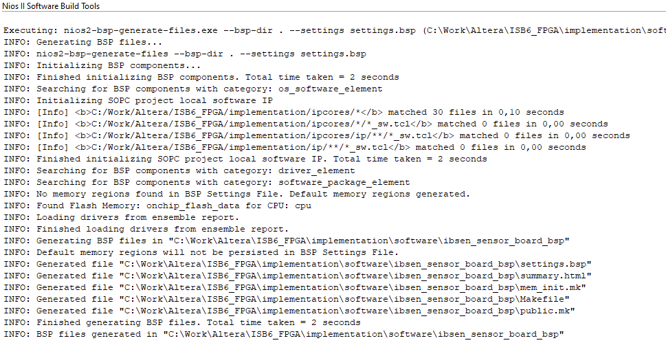

I have my project and I can generate the BSP both from inside Eclipse and from the NIOS II command line.

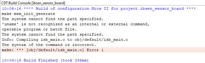

When I try to build my application I get:
Any ideas?
