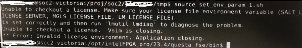

Need Help:QuestaSim Simulation report "Invalid license environment" with a valid license file.
I'm having a valid license for the Quartus 23.4 from FAE. I could open the quartus software GUI successfully but could not open the QuestaSim.Are there any configuration errors with my environment variable ?The environment parameter configuration as follow(set_env_param_1.sh):

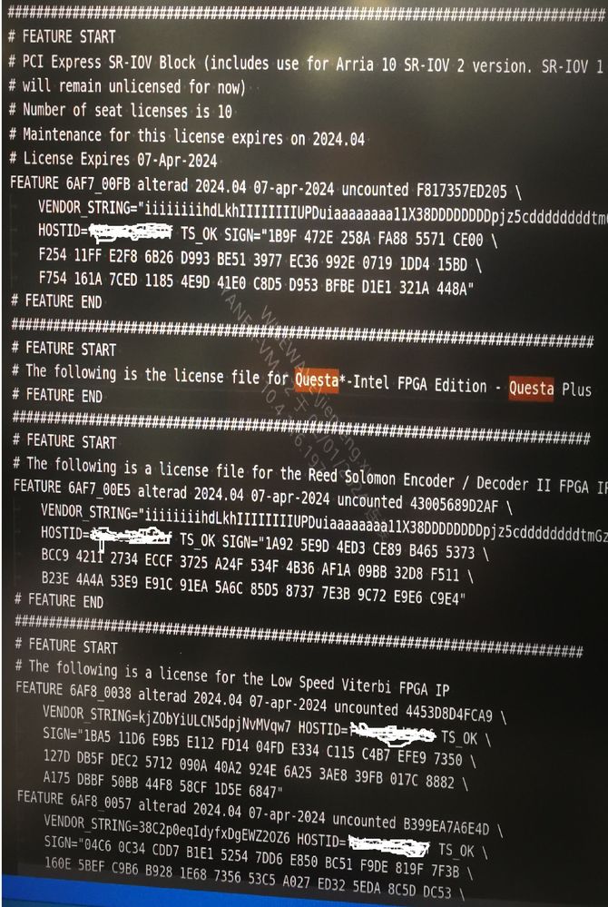

The license file as:
When I source the env file,it report error as:
if I enter qpro command, the quartus GUI would be opened with no license question.Why Questasim could not?

    You need to set your LM_LICENSE_FILE environment variable to point to the license that Intel provides. c:\intel\license.dat or something similar.
    You can refer to link on how to set environment variable.
    To make this entry, you may perform a windows Search for "System Variables" and then click on "Edit the System Environment Variables" and then click "Environment Variables". Be aware that you must add the entry in System variables, not user variables.
    https://www.intel.com/content/www/us/en/docs/programmable/683472/21-4/environment-variables.html
    • javen1122's avatar
      javen1122
      Thans for your help.I re-applied a new license file for Questa, the expiration date was a year.Now,The problem is solved and it works well.
