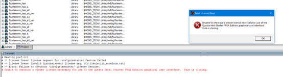

Just downloaded and installed "Questa*-Intel® FPGA Starter Edition" and got the license file but i get following result:

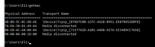

I generated the license with following info:

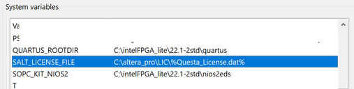

And defined the system variable:
Tried it with and without % around the Questa_License.dat wits same result...

    Create an environment variable of LM_LICENSE_FILE instead pointing to the .dat file. I don't know why the instructions say to do SALT since it never works.
