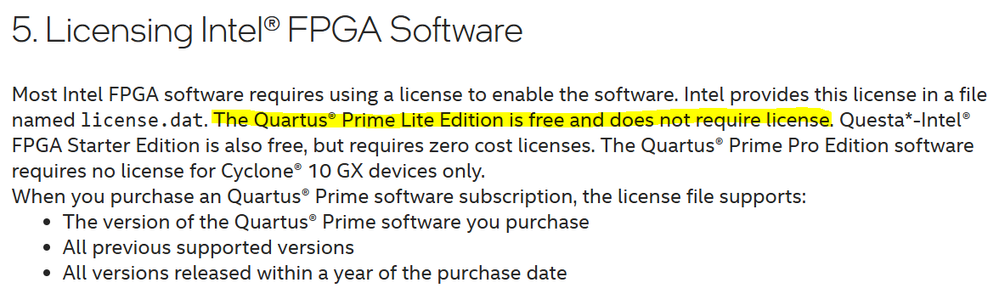

      Also, I though for the lite version of Quartus needs no licenses as shown in the below image.

    The NIOS V license is also available in the SSLC at no cost/free if you needed a change and used it. The Nios II/e core does not require a special license and is compatible with the free or web editions of Quartus. Additionally, Quartus Lite/Web Edition remains free and does not require a license.
