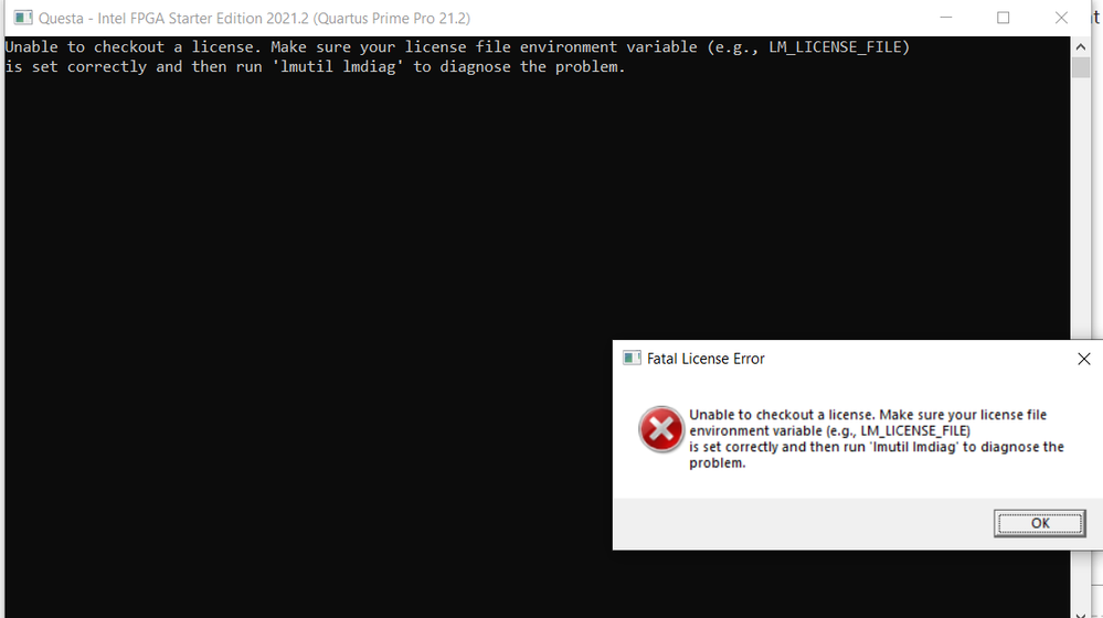

Hello @RichardTanSY_Altera , thank you for your reply.
As per your suggestion, I downloaded Questa - Intel FPGA Starter Edition v21.2. I have setup the LM_LICENSE_FILE in Quartus.
Now I'm getting this error - " Unable to checkout a license. Make sure your license file environment variables are set correctly and then run 'lmutil lmdiag' to diagnose the problem."
I verified the environment variable settings and it has the license path as follows -
C:\intelFPGA_pro\21.2\questa_fse\win64\1-V48SFZ_License.datI ran the 'lmutil lmdiag' on the console (refer to the attached image)
Request you to suggest resolves for this issue.

Hello @sstrell and @RichardTanSY_Altera ,
Thank you for your reply.
I generated the Questa license file from the provided link. I updated the LM_LICENSE_FILE path and now, I am able to open Questa successfully. Thank you very much for your help!
