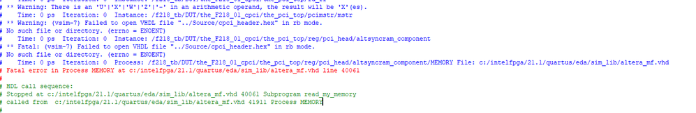

I am facing an error in Modelsim that I am not able to track it at all.
The error is
It is really confused me. I have the file "cpci_header.hex" and I have putted it in the all possible paths but still the same error. I don't know where should I put it.
Also, where is this path
Am I missing something? I tried to find a clear details about the error or where is my mistake but nothing useful.

Have you tried to delete the db folder recompile and rerun simulation?
Make sure the hex file is at the right path.

Do you mind to post the error message it here? log or txt file containing the error message?
For further analysis
