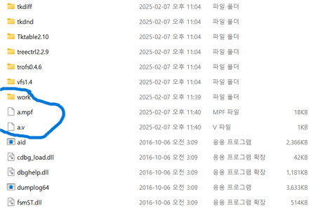

I still haven't solved the work(empty) phenomenon. But your advice was a hint, so I was able to proceed with the simulation I wanted. Thank you. However, this is only a temporary measure, and I don't know how long I can proceed with all the work I want. Let me explain my situation now.
When I create a project, I get work(empty), but I'm using the fact that if I create a source and store it directly in the work folder, I can compile it. Why does saving a project directly in the work folder get workempty and the source file is possible?
