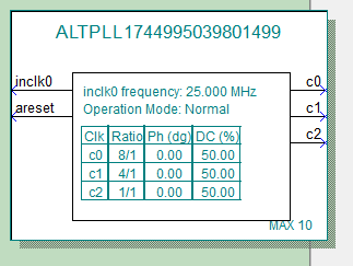

I have project which is build on 10M08DCU324 and same i am traying to migrate it to 10M16DCU324. After migration PLL block in my project is not working, just to check whether PLL is working or not i ...

1 year agoWhen you say you have migrated the design, what does that mean? Are you simply programming the new device with the same programming file from the old device or have you changed the device, recompiled the project, and generated a new programming file? If you haven't recompiled, then that's what you should try next.
