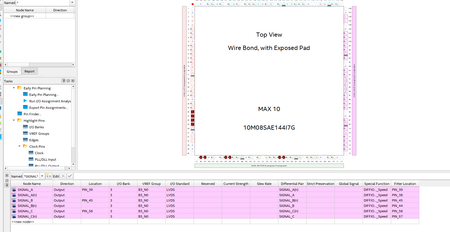

1 year agoMAX10 LVDS Output Issue in one Single Differential Pair
Hi, We are using the MAX10M08SAE144I7G and have a problem with a specific LVDS output pin. The signals A and C, which use pins 38, 39 and 57, 58, show correct LVDS signals on the oscilloscope. Howe...

sounds to me like broken PCB trace or not correctly soldered pin.
Which signal B voltage are you seeing? Can't be normal LVDS voltage with differential termination.

Hi, one of the differential pins was not soldered properly. Thanks!
