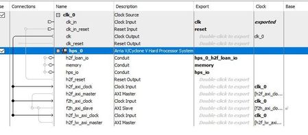

Hi there, already asked a similar question, but I just can't get a proper answer. Coming from this: [1] https://forums.intel.com/s/question/0D50P00004NVx2bSAD/how-can-i-use-the-loan-io and this [2...

looks like the procedure you followed is right.
instead of connecting to the UART , please connect to another FPGA pin with direction only as out,
From the HPS , toggle the pin and measure from the FPGA side. If you are able to see the toggle ,from the HPS side to FPGA fabric it is connected.
That is how we can check LoanIO function is working. Please let us know the results after trying.
