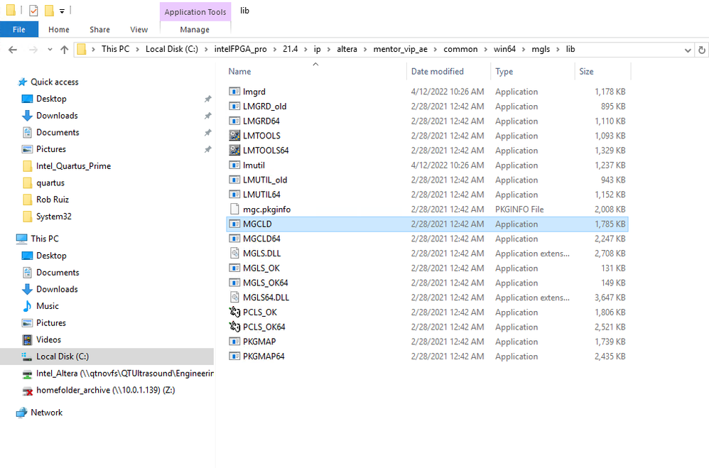

    I reviewed the video when initially setting up the license server and again today. There is no information for troubleshooting this issue.
    The license file specifies the following:
    VENDOR mgcld C:\intelFPGA_pro\21.4\ip\altera\mentor_vip_ae\common\win64\mgls\lib port=1802
    The debug log contains the following:
    10:26:42 (lmgrd) CreateProcess error code: 0x5 File= C:\intelFPGA_pro\21.4\ip\altera\mentor_vip_ae\common\win64\mgls\lib
    10:26:42 (alterad) FlexNet Licensing version v11.18.2.0 build 281478 x64_n6
    10:26:42 (lmgrd) License server manager (lmgrd) startup failed:
    10:26:42 (lmgrd) File not found, mgcld.exe
    In this screenshot you can see that the mgcld path is correct.
    Do you have any recommendations for what I should try next?
  • AR_A_Intel's avatar
    AR_A_Intel
    Hi
    Upon checking the license file, it does not direct to the correct mgcld.exe file.
    It should look like this, with the mgcld.exe.
