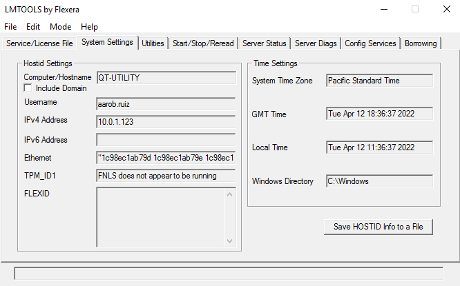

- MarkSlovick
The problem is persisting. The debug log indicates that mgcld.exe is not found. LMTOOLS also indicates that FNLS is not running. Is that significant?
