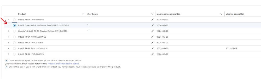

    Quartus 22.1 uses Questa simulator. A free license for Intel Starter Edition must be requested and installed on your computer. Method described on Quartus download pages and recently discussed in this forum.
    • AlleeKhaan's avatar
      AlleeKhaan
      I downloaded it and followed that method. Although i didn't install anything for Questa. Do i also need to download it as well?
        AlleeKhaan
        I already download this one but not sure if i also need 3 option.
    AlleeKhaan
    I resolved it.
    It was environmental variable issue.
    Created new variable and gave the path to license file. It resolved.

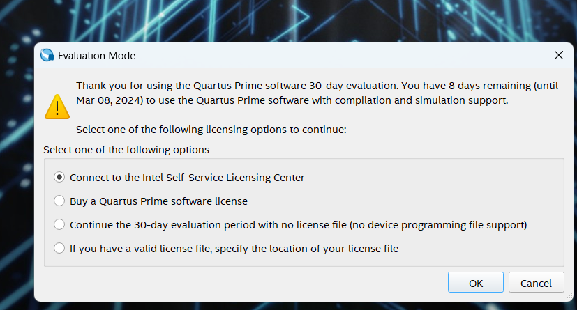

  • hello sir
    recently i downloaded quartus prime 22.1 std version and downloaded license also but i got this message and also when i am starting simple example hello world using niosv processor the .sof file is not generated in output files please give me suggestion sir tq
