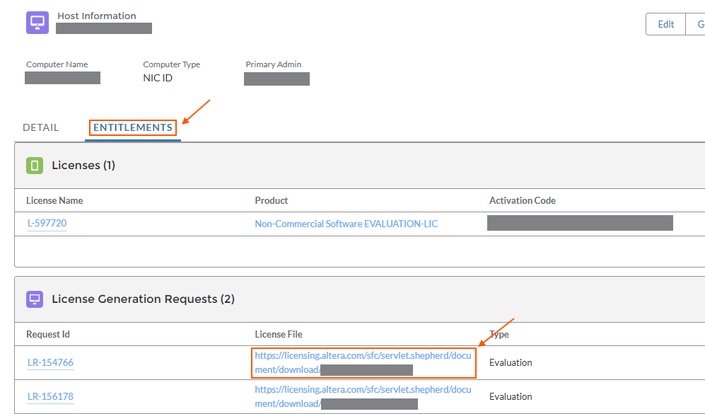

   ii) Manual License File Download (License Email Not Received)
If you generate a license but do not receive the license email within 5 minutes, you can manually download the license file using the steps below:
  1. Log in to SSLC.
  2. Navigate to Computers and License Files.
  3. Click the Primary Computer ID.
  4. Go to the ENTITLEMENTS tab.
  5. Select the relevant license (for example, LR‑****).
  6. Click the license file link to download the license file. Example shown below:

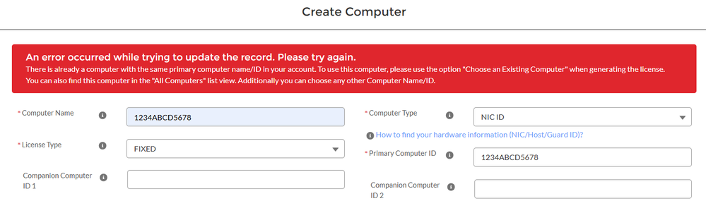

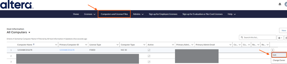

   iv) Changing License Type (Fixed ↔ Floating)
To change an existing license type:
  1. Log in to SSLC.
  3. Navigate to the license file and click Edit in the drop-down menu.
  4. Change the License Type to FIXED or FLOAT, click Save.
  5. Now you can generate the license file with the Existing Computer.
For your reference, this error occurs when you attempt to create a computer with the same NIC ID. You cannot create two computers with the same NIC ID, even with different license types.
*Additionally, changing the license type will use up one rehost count. If all 3 rehost count have been used up, you can not change the license type for the specific computer anymore.

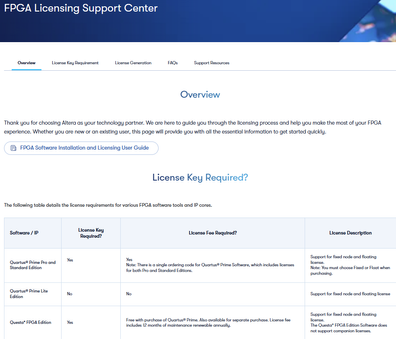

For further information related to licensing, you may check out Altera Licensing Webpages for the wholesome experiences to get your FPGA licensing product setup and running with minimal hassle:

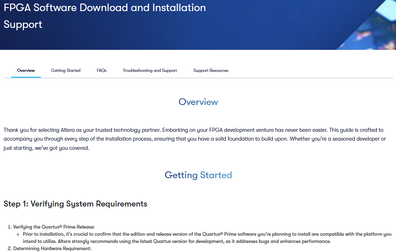

Additionally, we have FPGA Software Download and Installation Support webpage:
