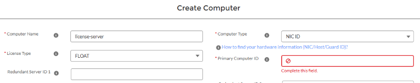

   iii. Choose one of the following:
        - An existing computer with FLOAT license type
        - Or select + New Computer, in the Create Computer, choose FLOAT license type, and enter the
           license server NIC ID / Host ID
   4. Generate and download the license file (.dat).

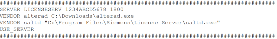

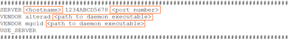

*If you’re running a floating license server for Siemens licenses, you need to manually change the VENDOR daemon line in the license file from mgcld to saltd. It is optionally to put user-defined port numbers for the alterad and saltd daemons unless you have specific port numbers that allow firewall access. In this case, I left it empty.
------------------------------------------------------ END ------------------------------------------------------
   ii. At the end of Step 2, your license should looks similar like below (Windows):
Important to note: Use “” if there is space in the path.

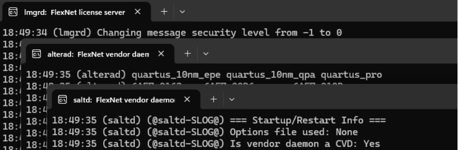

a) Using the Command Line Interface (CLI)
i) Open a Command Prompt (Windows) or Terminal (Linux).
ii) Change to the directory where the lmgrd executable is located.
iii) Start the license server by running command:
lmgrd -c <license.dat>
Example: lmgrd -c float.dat
This command starts the license server using the specified license file.
You will see a few windows pop up showing that the daemons are running.

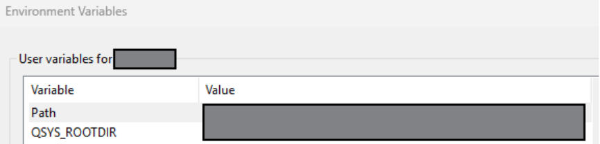

Helpful Tips 2:
----------------------------------------------------- START -----------------------------------------------------To make things easier - skipping the a) ii) step, you can add the path directory that contains lmgrd to your system’s Path environment variable. Once it’s added, you can run the lmgrd command directly from any directory  in the Command Prompt.

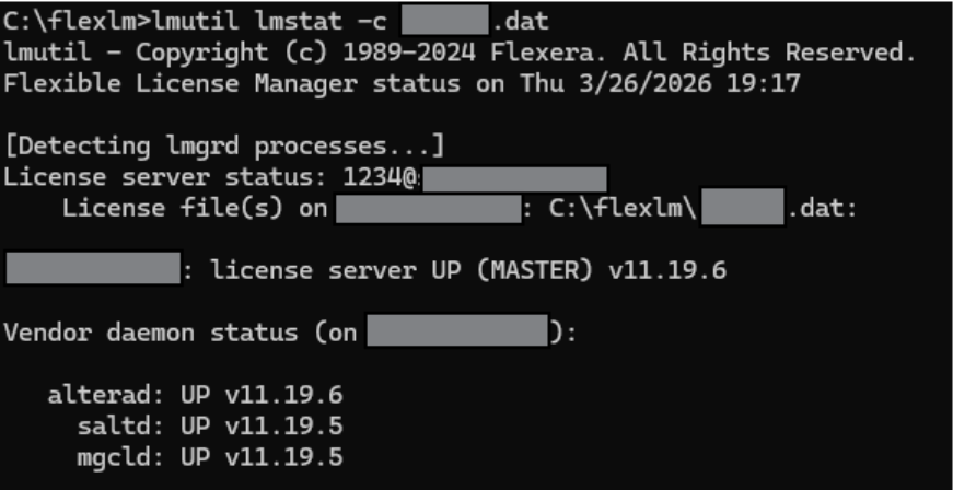

iv) To verify the license status. Run:
lmutil lmstat –c <license.dat>
Example: lmutil lmstat –c float.dat
How to Read the above info:
Line
Note
License server status: 1234@<hostname>
This contains the license server name needed for the license environment variable setup. It is displayed in the form of <port number>@<hostname>
License file(s) on <hostname>: <License Path> :
This showed which license file is being used. This is where you make sure the license file you are using is correct.
<Hostname>: license server UP (MASTER) v11.19.6
This mean the license server is up successfully.
Vendor daemon status (on <hostname>):
This showed the vendor daemon status and the daemon version you are using. Make sure the version used is the latest version available.

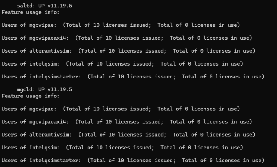

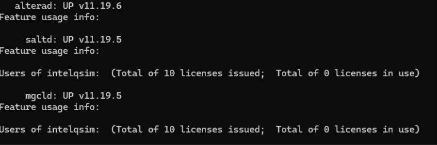

  • The above command just display the overall status of the license. You can add -a option in the command to report out the verbose list of available licenses and its total numbers of seat, example:
    lmutil lmstat –a –c <license.dat>
    Example: lmutil lmstat –a –c float.dat
  • To check a specific feature:
    lmutil lmstat –c <license.dat> -f <feature name>
    Example to check the Questa Altera FPGA Edition license:
    lmutil lmstat –c float.dat -f intelqsim

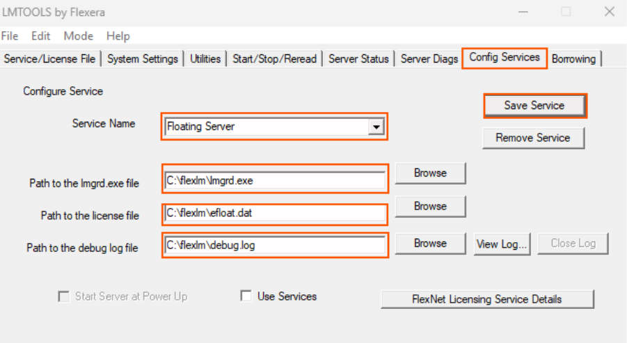

b) Using the Graphic User Interface (GUI)
1. Right‑click lmtools and select Run as Administrator.
2. In the Service / License File tab, select Configuration Using Services.
3. Switch to the Config Services tab and configure the required fields below:
4. Click Save Service.
5. Go to the Start / Stop / Reread tab and click Start Server to launch the service.
6. Click Stop Server to shut it down.
