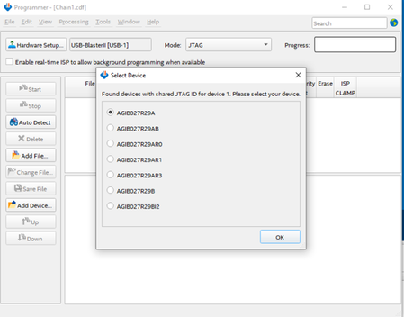

2 years agoJTAG - USB blaster 2 does not identify the FPGA
Hi, I am using the Programmer to load the FPGA. This is Quartus 23.4 When I select USB-1 and click on "Auto Detect", it shows me a list of options for the FPGAs. Issue: FPGA that I am using is no...
- 2 years ago
Yeah, it doesn't really matter which device you pick in the auto detect dialog (which is something that has confused me for years). When you select your programming file, it will get the correct device from that.
