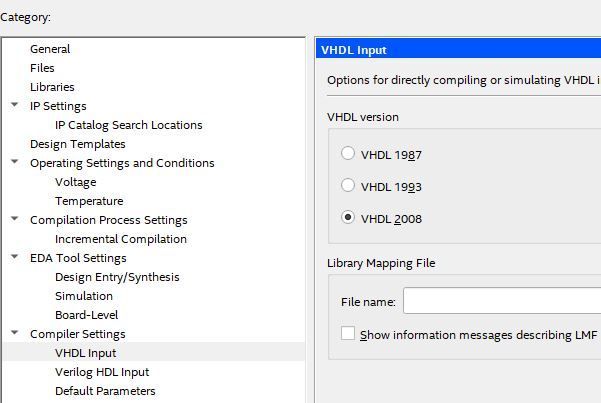

I downloaded 23.1std.1 build 993 05/14/2024 SC Lite Edition.
It does have support for 2008!
