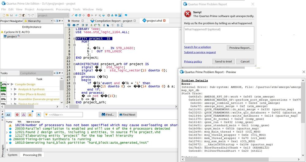

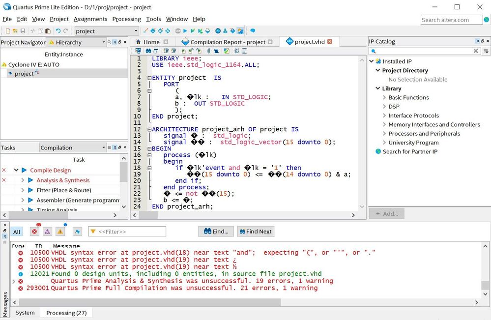

And here is a specially created simple project with Russian letters, leading to the above internal quartus error. I post the source code and a screenshot.
- AGarm
Only after saving the file with the Quartus editor are syntax errors found correctly.
