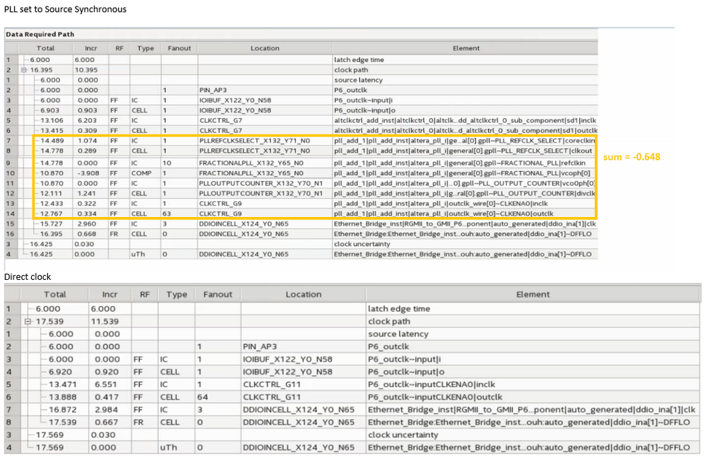

I'm constraining a double data rate RGMII input interface.
For reference - I'm using page 15 in this document:
The input path passes timing - But the output does not.
I used a PLL with zero phase shift for the output clock.
My design is attached.

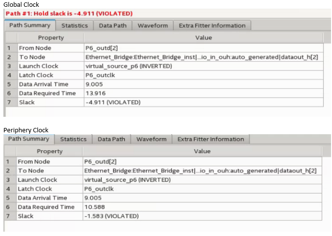

    Shifting the latch clock does not help in this case - This refers to the path in the design without PLL.
    "Take an example of the path in the design without PLL, the amount of setup slack is smaller than the amount of the hold violation. Shifting the latch clock does not help in this case."
    From the report, there is setup slack of 3.839ns and hold slack of -4.917ns for the path mentioned above as an example. Setup slack of 3.839ns means the signal arrives at a time of 3.839ns earlier than what is required. Hold slack of -4.917ns means the current signal has to stay for another 4.917ns longer before the next signals comes in. If the new signal arrives the destination after another 4.917ns, the signal will fail the setup because the setup slack has only 3.839ns.

    In the design you have attached, there is hold violation for some paths. The data arrival time is less than the data required time. From the screenshot above, you can see that the data required time improves a little (-0.648ns) but this is not enough. After adding the PLL, the data required time is reduced by this amount but it is still larger than the data arrival time. If you change the pin location to increase the data arrival time, you will see positive hold slack.
