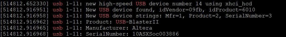

Intel FPGA Download Cable II not work in the Intel Quartus Prime Pro Edition software version 19.1 after the Patch istalled also

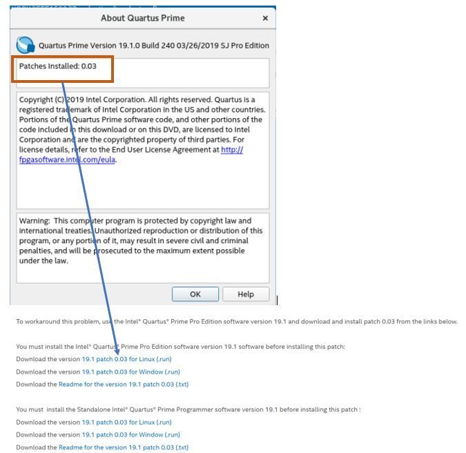

I am running Quartus prime pro on linux machine and Arria 10 board i have connected to the server. USB blaster II cable from board is also connected to linux machine.I have referred the below link and installed the patch also. But when i do 'dmesg' as told USB-Blaster cable is not detecting, Error log after 'dmesg' i have attached. Please can you suggest workaround to resolve this issue.
https://www.intel.com/content/altera-www/global/en_us/index/support/support-resources/knowledge-base/component/2019/why-does-my-usb-blaster-ii-not-work-when-using-intel--quartus---.html

    I have resolved the issue, it was the 'Cable' issue, after changing the cable and restarting. Board is up now
