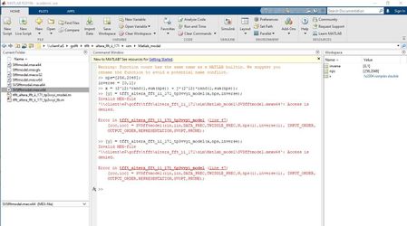

6 years agoIntel FFT simulation was failed in 2 Matlab version
Hello Sir/Madam, Quartus prime pro 17.1 + Modelsim 10.5c +Arria10gx Intel FFT IP core , Variable Streaming,N=256,data type is single. I generated an Intel FFT ipcore from Quartus, I can see some ...

As I understand it, you encounter some issue when trying to simulate the Matlab model generated together with the IP HDL generation. For your information, can you try the following:
1. In your FFT IP, Generate the Example Design
2. In the generated folder ie fft1_ii_0_example_design, look for Matlab_model folder
3. You can find the model.m and _tb.m in the folder
4. Try run the Matlab simulation using these files.
Please let me know if there is any concern. Thank you.
