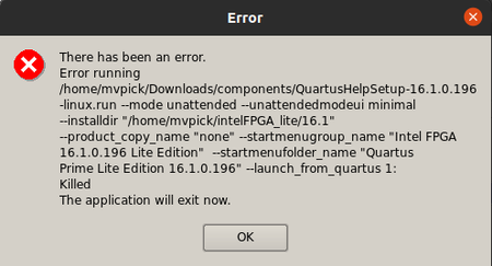

Installation of Quartus Lite 16.1
- 6 years ago
Have you checked the software requirements are met in the User Guide below? Try to follow the installation steps in the 3.3.2. Installing Intel FPGA Software at the Command Prompt.
Intel® FPGA Software Installation and Licensing
Any reason why Quartus Lite 16.1? As the up-to-date Quartus lite version available to download is version 20.1. which includes the latest functional and security updates.
- mVpick6 years ago
I've already downloaded the latest version I was curious about version 16.1 because of the online training that I'm undergoing asked to download that version.
Thank you for your help.
