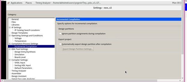

this option available in assignment -> settings -> Compilation process setting -> Incremental Compilation
- sstrell
It's in the Tools menu under Advisors, not in the Settings dialog box.

- Yogesh
But I find no advice for timing improvement?
I only find below options.
