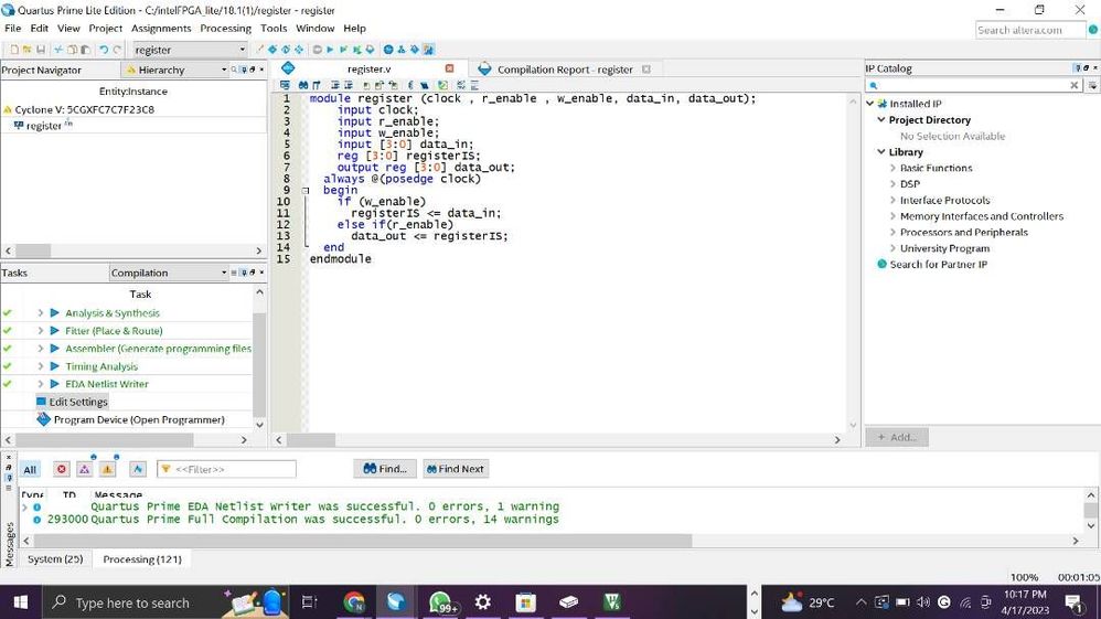

I having problem with University Program VWF.
I can run the functional simulation waveform but the output is always 0000. How can I fix that? I use Quartus II 18.1 version.

      This is the code that I use:
      module register (clock , r_enable , w_enable, data_in, data_out);
      input clock;
      input r_enable;
      input w_enable;
      input [3:0] data_in;
      reg [3:0] registerIS;
      output reg [3:0] data_out;
      always @(posedge clock)
      begin
      if (w_enable)
      registerIS <= data_in;
      else if(r_enable)
      data_out <= registerIS;
      end
      endmodule
