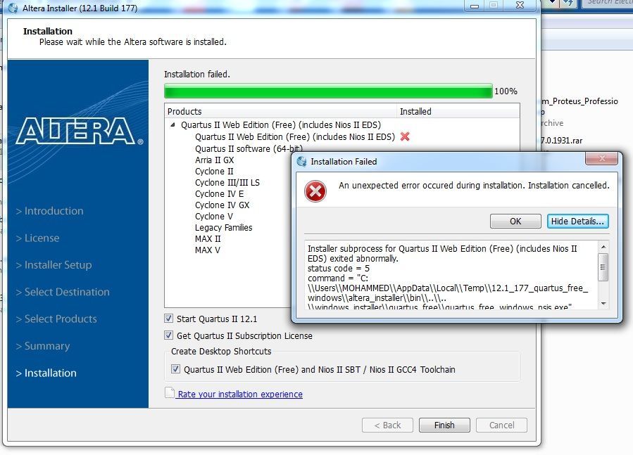

I have this error message when i install QUARTUS II 12.1: Installer subprocess for quartus II web edition exited abnormally status code = 5.

    May I know what OS that you were using for this installation?

      I use windows 7/ 64bit.

    Check if you are running under admin?
    1. Right-click on the .exe and choose "Properties."
    2. Then click the "Advanced" button at the bottom of the window that opens.
    3. Check "Run as Administrator".

    i tried, but the problem not fixed
    I have found the solution,
    the solution is the internet connection must exist in installation
