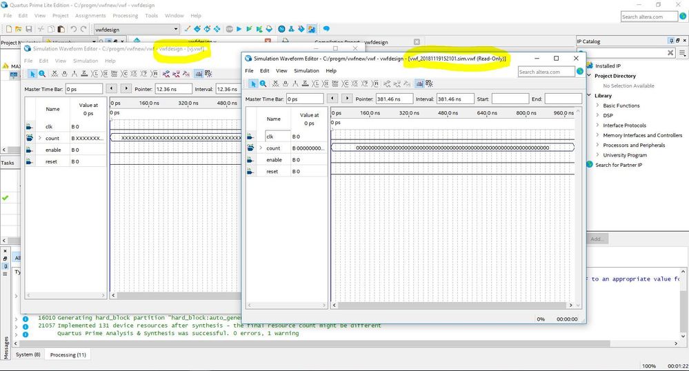

I have a problem with Quartus Prime 18.1 Lite Edition. More specifically, when creating a .vwf file for the Simulation Waveform Editor, a few lines within the file are quite wrong. Attached is a Word document with details.

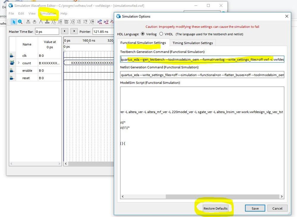

Can you check once the 'Restore Defaults' under Simulation -> simulation settings?
it will generate as you looking for, check the below screenshots,

Perhaps I should have mentioned that I have always been clicking on the Restore Defaults button, right after setting up pin assignments, and prior to saving the file - Simulation -> Settings is unavailable before going through pin assignments, and is disabled before that.
The Restore Defaults changes the initial file name in those lines I highlighted from Waveform.vwf to <project name>.vwf (light.vwf in my example) but it does not correct the messed up paths.
When I described the problem originally, I was trying to point out that this erroneous path is created right at the get go when the Simulation Waveform Editor is invoked.

'The Restore Defaults changes the initial file name in those lines I highlighted from Waveform.vwf to <project name>.vwf (light.vwf in my example) but it does not correct the messed up paths.'
Actually I have only one drive(C) so I couldn`t see any change,check attachment.
Can you check it by creating project under installation directory?
First save '.vwf file' & then go for 'simulation setting'

Hi Vicky, I tried your suggestion of creating the project under the installation directory, but the condition persists. I documented the whole exercise in some detail with lots of screen shots in the hope that you, or someone, may spot something that rings a bell somewhere. Despite the length of the document, it should be pretty quick for you to go through since they are all screen shots you would be very familiar with, and brief comments from me. The document you sent (the dffdesign.vwf file) has been helpful in that I now realize the default in the process of setting up the Simulation Waveform Editor is <path><file name> rather than simply <file name>, so my work around edits are a bit less tedious to do. Rashid - Vicky1

Please check the below steps carefully & provide the screen shot like below,
- First save the .vwf file from file Menu.
- Go to 'Simulation' -> 'Simulation Setting' -> 'Restore Defaults' -> save.
- Then 'File' -> 'Save'
- Eventually 'Simulation -> 'Functional Simulation'
- provide the screen shot like below & vwf file with notepad extension.
