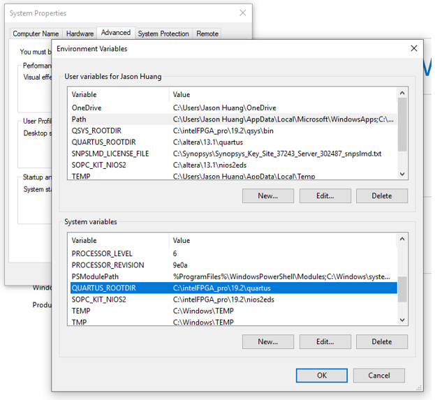

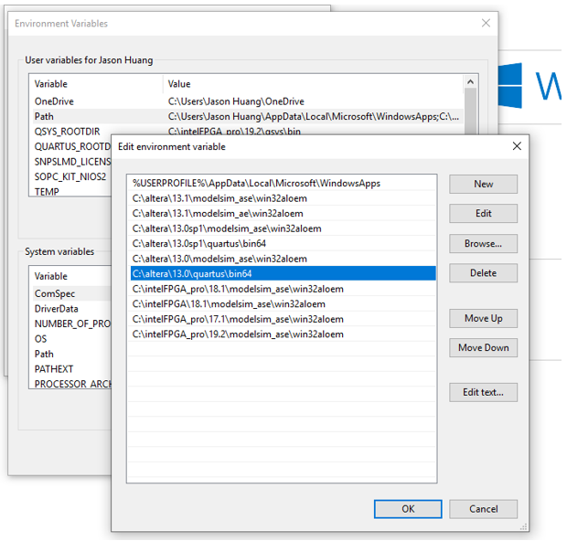

      Vicky, I checked the environment variable setting for my computer. The Path Value is Quartus 13.0 while the QUARTUS_ROOTDIR Value is Quartus 19.2. I am not sure if this is correct. Attached is the images for the Environment Variables. Thanks, Jason

      I checked the environment variable setting for my computer. The Path Value is Quartus 13.0 while the QUARTUS_ROOTDIR Value is Quartus 19.2. I am not sure if this is correct. The images of Quartus environment variable are attached.

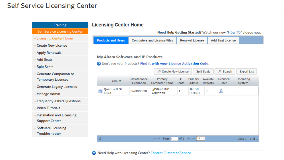

      I did restart the computer after installing Quartus Pro 19.2, but the result is the same - no Stratix device is available. Also, at the 'My Altera Software and IP Products' in 'Self Service Licensing Center', Quartus II SE Fixed is under 'Product' column, nothing else. Please see the attached.
