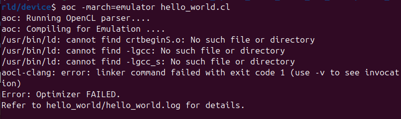

I am getting an Error while using Intel FPGA SDK for emulator Compiling for Emulation .... /usr/bin
This is the error

Could you let us know which version of OpenCL that you are compiling with? Also which sample design that you are building? As well as the command used to build.
Those information would be useful to help us understand the situation further.

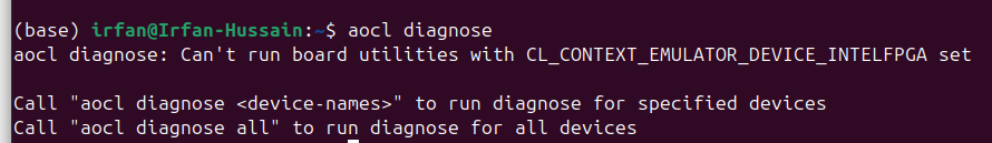

- can you please run and share the output of the 'aocl diagnose' command

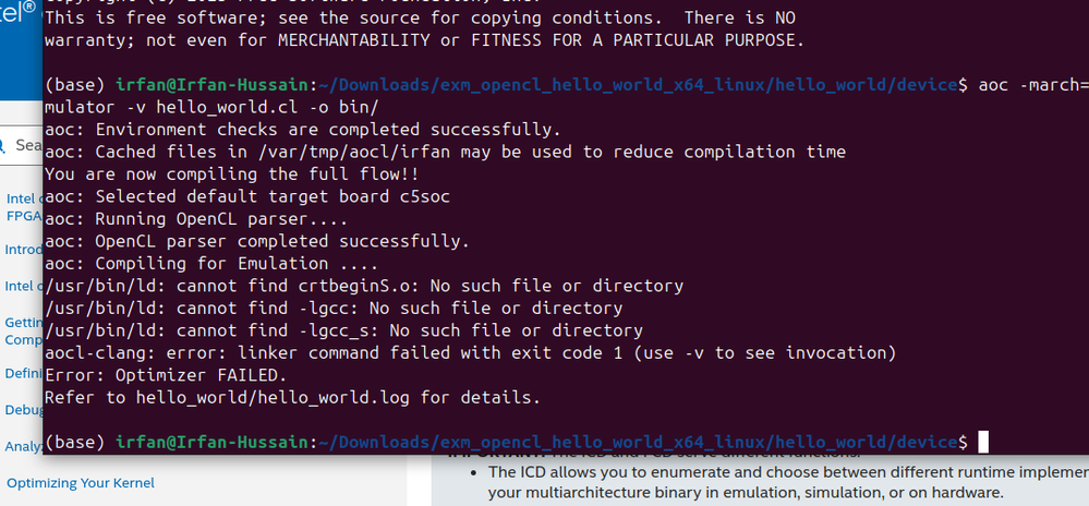

- there should be a sample design available somewhere in the following path (<path_to_exm_opencl_hello_world_x64_linux_<version>>/hello_world), can you please try compiling that instead.

- Irfan191
I am looking forward to use the emulator
when running the example

Thank you for the patients, after some alignment we suspect that the culprit might be the missing GCC compiler which the OpenCL may required for emulation, hence would suggest to check of the gcc is install and also the required minimal version for the compiler compatibility with the link below:
- https://www.intel.com/content/www/us/en/docs/programmable/683188/21-3/gcc-requirement.html
Once correct GGC version is installed would recommend to source the 'init_opencl.sh' script to set/re-set the environment variable to ensure all is correct. The script can be found in the opencl installation path.
